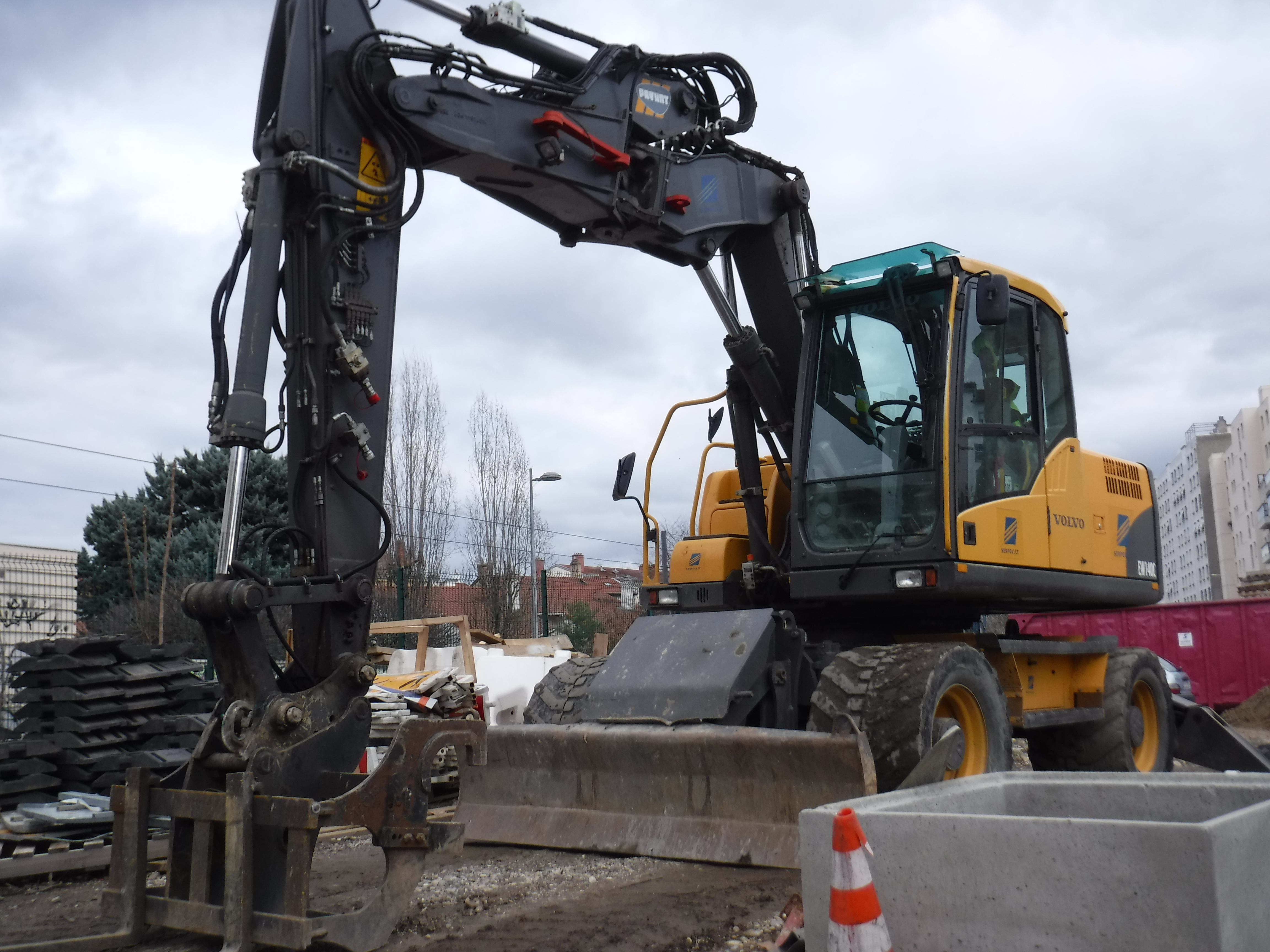

VOICI LE CHASSI PENEUS TOUT EN ALU SAUF LA COURONNE DE ROTATION
ET LA VOILA A L ECHELLE 1/1
